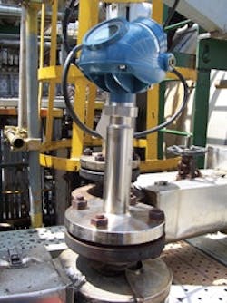

Non-contacting Radar
Figure 2. Measurements require a clear unobstructed view of liquid surface.
Non-contacting radar (Figure 2) demands careful consideration of process conditions and installation constraints. It requires a clear unobstructed view of a liquid surface. An unrestricted mounting nozzle also is important. The measured surface must be relatively flat, not slanted. Non-contacting radar gauges can handle agitation -- but success depends on the fluid properties and the amount of turbulence not limiting the return signal too much. Low dielectric fluids reflect very little radiated energy back to the gauge. Additional signal loss occurs if the liquid surface is turbulent, whether from agitation, product blending or splashing. To overcome this, you can use bypass pipes -- including self-contained chambers or stilling wells to isolate the surface from turbulence.

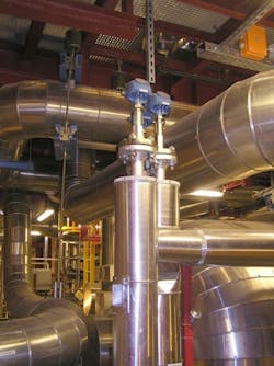

Such bypass pipes (Figure 3) provide a calmer surface in case of turbulence. They offer external mounting with valves, allow for easier servicing of level devices and enable radar measurement in tanks such as towers that only offer side connections. Always provide multiple holes or slots on one side of the pipe to ensure good fluid flow-through.
Both GWR and non-contacting radar work well for pipe or stilling well applications, but GWR is far simpler to install and maintains accuracy and sensitivity independently of the pipe. For these types of applications, correctly dimensioning the chamber and selecting the appropriate probe are essential.
Choose 75-mm or 100-mm chambers. Smaller ones raise risks of build-up and flow-through problems, and increase the chances of the probe contacting the chamber wall.
Select a single probe, as it is less susceptible to build-up. Most chamber installations rely on rigid probes but flexible ones also may also be used. Ensure the probe is suspended vertically and does not touch the pipe wall. A "centring" disk can keep the probe properly positioned away from the wall.

Figure 3. Using external chambers for level measurement can cope with turbulence and enable easier servicing of device.
For shorter pipes, use GWR with rigid probes. GWR with flexible probes can work in long pipes, but the probes must remain taut and away from the wall. A combination of weights and centring disks can achieve this. For longer pipes or when head space for installing probes is limited, opt for non-contacting radar.
