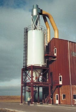

First things first, a weighing application will never be successful without proper attention to the tank. Vessels are usually designed to safely hold a quantity of material accounting for such factors as wind, earthquakes and other forces of nature. The idea that the vessel will need to weigh a material is generally an afterthought in its design.
The most important factor to consider when designing for a weigh cell is the construction of the “weighing frame.” The frame is where the load cells will be mounted. Whether the cell is a shear beam, bending beam or compression type does not matter. This structural steel is mechanically connected to all the load cells under the vessel to ensure that they cannot move in different directions independently of each other. Because we’re only interested in vertical compression forces the design must resist external forces that could cause the load cells to tilt.
Figure 2 shows the best type of installation. Notice how the load cells are placed in the middle of the beams. Each cell is situated between two frames. This frame network ensures the load cells will move together, creating a more repeatable weighing environment.
Figure 2. Constructing a rigid frame is critical for repeatable weighing.
In Figure 2 the load cells are mounted on top of a bottom frame assembly that provides a rigid foundation. The weight of the vessel is being transferred to the load cells and then to the bottom frame. This transfer of force occurs with minimal deflection. Although the load cells can be mounted directly to the floor without the bottom frame, the floor must allow little deflection and settling. The load cells are measuring deflection down to thousands of a millimeter, so if your foundation deflects, you aren’t going to achieve acceptable accuracy. Most architectural designs allow a floor deflection that would be unacceptable for weigh cell operation.
Figure 3 illustrates another typical design problem found in tank weighing. It shows load cells installed on the end of very long tank legs. In this example, errors are due to the legs moving in different directions. Measurements become unrepeatable as extraneous deflection causes variability in movement.
Figure 3. Shortening the span between the tank base and the weigh cells reduces the bending moment causing poor repeatability and inaccuracy.
The second drawing in Figure 3 illustrates a good load cells’ installation; the legs from the tank are shorter, minimizing separate leg movement, and the load cell has a top and bottom frame to help induce a more uniform loading pattern. These figures show a common error; each weighing applications is different.
