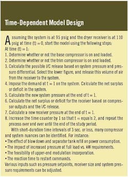

Computer modeling requires a series of tradeoffs among accuracy, complexity and desired results. Microsoft Excel or other commercially available spreadsheet software can be used to program a computer model that can be executed quickly.
The key questions in designing a time-dependent model are:
What characteristics or results are to be identified by the model?
What time interval is required to accurately illuminate these characteristics?
What and how much data are required?
What constraints related to data processing or data storage are present?
Each of the questions involves a decision about what time interval (Dt ) the model should use. Selection of a time interval depends on the individual system and how the results will be interpreted.
Systems that are relatively static can use longer duration intervals and provide enough detail for meaningful results. For instance, a hydroelectric reservoir system might need only daily stream inflow averages to determine storage and release levels. A heating, ventilation and air conditioning (HVAC) system might need only 15-minute temperature averages to determine when to switch from unoccupied to occupied status each morning.
These systems can be considered static in that their storage is very large (e.g., a hydroelectric reservoir) or the demands on the system (HVAC) change slowly. Compressed air systems lack either of these characteristics.
Consider a typical system with 2,000 gallons (gal.) of storage and a 1,000-cubic-foot-per-minute (cfm) compressor with an average system demand of 700 cfm. If the compressor experiences a fault and shuts down, the air pressure will drop 10 pounds per square inch gauge (psig) in approximately 16 seconds (sec.). Pressure and flow in an air system can change rapidly and, in many cases, data collection intervals greater than 15 sec. might be too long to provide results with enough clarity.
