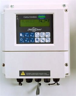

Severn Trent Services’ MicroChem 2 is a new generation family of transmitters and controllers, suitable for all the needs of analysis and process control. It is capable of measuring and transmitting up to three of the listed parameters in every desired combination: pH, Iodine, ORP, conductivity, dissolved oxygen, temperature (PT100), fluoride, ozone, bromine, analog 4–20 mA or 0–20 mA, chlorine dioxide, chlorine (free and total; buffered and bufferless).
The units also feature a triple input signal, PID standard with feed-forward control functions, triplication control, automatic thermocompensation, aeration basin/swimming pool control and menu-driven software.
