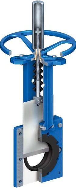

ITT Engineered Valves offers the Fabri-Valve 33 PTD push-through slurry valve for harsh demands of light to medium slurry applications. The 33 PTD is most suitable for copper, gold, silver or phosphate.
The 33 PTD incorporates a UHMW gate support liner, which can help provide smooth gate operation and alignment while eliminating body wear. The elastomeric seats have been engineered to provide a high degree of abrasion resistance and chemical compatibility. The valve seats form a pressure boundary for maintenance of gate and actuation while under pressure.
The 33 PTD was designed with dead-end service capability. The push-through seat design is self-cleaning and has low discharge. The 33 PTD is available in sizes ranging from 3 -inch through 24-inch diameters (DN 80-600). Sizes 3 inches to 16 inches (DN 80-400) operate at 150 psi (10.3 bar) and up to 180 degrees Fahrenheit (82 degrees Celsius). Sizes 18 inches to 24 inches (DN 450-600) operate at 90 psi (6.2 bar) of working pressure and up to 180 degrees Fahrenheit (82 degrees Celsius).
