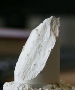

Uniaxial testing involves measuring the force needed to break or fracture a column of consolidated powder. It is considered a simple and direct method of measuring unconfined yield strength, a parameter related to cohesivity. In the past, use of the technique has been inhibited by the difficulties inherent in repeatedly producing a uniformly packed and consolidated powder column for testing. As a result, unconfined yield strength data are routinely derived from shear testing, a less direct but practical alternative.
Freeman Technology has developed a new accessory that, in combination with a well-defined consolidation methodology, produces a homogeneous, uniform powder column for testing. Measuring the normal stress required to fracture the column directly identifies the unconfined yield strength. Comparative tests show that the new solution produces data closely comparable to those derived from shear test data, but offers improved repeatability, according to Freeman.
