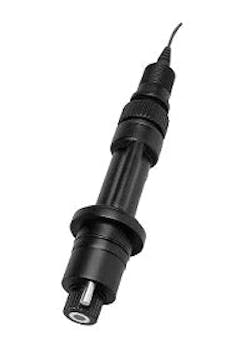

The Sensorex modular 8000 series flat-surface, self-cleaning electrode platform is designed for versatility and flexibility. You purchase only the components you need, and can adapt what you have to changing installation needs or interface options.
The sensor utilizes Sensorex’s flat-surface, self-cleaning technology. The reference system has been enhanced with Sensorex’s ERP technology, which provides a complex path that protects the reference in the presence of interacting ions such as proteins, silver and sulfides that interact with silver or chloride. Heavy-duty, high-temperature reference gels offer protection against thermal breakdown of the gel. The same electrode is used for in-line or submersion applications and is constructed in a chemically resistant PPS body.
Current S650CD submersion installations utilizing S653 or S653TC vintage cap/cables can utilize an EA adapter to interface the 8000 series sensor without replacing the original cable assembly.
In-line mounting is accomplished using the main EA899 or EA899TC interface along with the FC800 flow cell. The main EA interface can be ordered with or without ATC elements.
For applications which require more than a direct electrode output, plug-in electronic modules are available.
The first three available are:
- Battery powered unity gain module EM800
- Battery powered differential module EM801
- Blind two-wire 4-20 mA transmitter EN802/pH or EM802/ORP
Cap/cables are available in two standard lengths, 10 feet and 25 feet. Both cap cables utilize an eight-pin connector.
