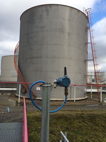

Wireless Transmitter
Figure 1. Leak detection system relies on discrete wireless transmitters to send data from sensors and sensor cables that detect xylene and benzene.

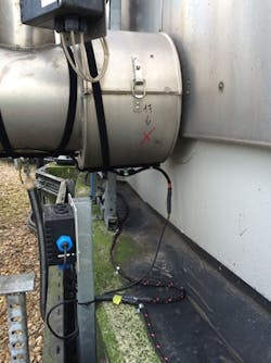

Crucial Cables
Figure 2. Sensor cables are placed on the concrete base surrounding a tank as well as underneath connecting piping and around tank flanges, valves and manholes.
The leak detection system uses eleven Rosemount 702 wireless discrete transmitters from Emerson (Figure 1) in combination with Pentair (formerly Tyco) fast fuel sensors and TraceTek sensor cables. When one of the sensors detects xylene or benzene, the associated Rosemount 702 wirelessly transmits an alarm signal to a Smart Wireless Gateway for relay to the control room where operators monitor and record the status for accurate incident reporting and time stamping in the host control system. The 702 discrete input/output devices are part of IEC-standard WirelessHART field networks.
The TraceTek sensor cables are attached to the concrete bases surrounding tanks to detect leaks from the tank wall (Figure 2). They also are laid underneath connecting piping and draped around the tank flanges and manholes as well as valves. The fast fuel sensors detect hydrocarbons in sump wells and pump skids. Leaking xylene or benzene upon touching the sensor cable or sensor completes a circuit. This sends a discrete input to the 702 input/output device that transmits it wirelessly to a gateway that relays data to the control room.
