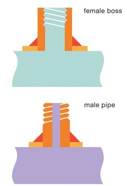

THREADED TAP NOZZLES
Figure 2. These nozzles feature either a female threaded boss or male threaded pipe nipple to connect the process line to the sampling system.

CONSTRUCTING A NOZZLE
As you move into the design stage, you’ll notice that nozzle design, including orientation, highly depends upon the needs of the probe. Nozzle, and therefore probe, location and orientation can influence how particles within a process stream affect analysis. The right nozzle and probe placement can minimize the potential for particles to enter the probe where they may contaminate the sample or collect and eventually block the probe.
The simplest way to construct a nozzle is to weld a female threaded boss to a pipeline and drill it through (Figure 2). First, weld a reinforcing plate to the pipeline, unless its wall is adequately thick. Next, select a boss size to accommodate the threaded probe or valve being used. Another approach is to weld a male threaded pipe nipple onto the line (Figure 2).

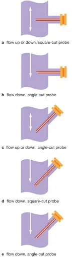

VERTICAL GAS LINE
Figure 4. Tap orientations and probe end designs vary depending upon process sample conditions.
Of course, neither of these simple methods will satisfy a process piping specification that prohibits threaded joints at the process envelope. Facing these constraints, you can weld a valve onto the nipple or use a flanged pipe nozzle instead.

Whenever possible, choose a horizontal pipe for sampling process gas. The horizontal orientation allows the nozzle to be vertical. It’s also easier to find a long, straight run. Locate the nozzle on top of the line (Figure 3) so any dirt or liquid falls back into the process pipe.
If the process gas is clean and dry, you could locate a gas nozzle on the side of a horizontal pipe. However, avoid such a horizontal probe orientation for dirty samples because the gas flow in the probe may not be turbulent; solid particles could fall out and block the probe
The same concern for blockage applies to a horizontal nozzle on a vertical gas pipeline (Figure 4). The inclined nozzles also shown in Figure 4 allow any entrained liquids or solids to fall back into the process. This feature works well for liquid removal but may not for solids, which may stick in the probe
For vertical stacks, the nozzle should be horizontal or slightly inclined and much larger — sized to accommodate special probes. Here, nozzle location is based on the gas temperature: not too hot (so material costs are reasonable) but above the acid dew point temperature (so sulfuric acid doesn’t condense in the probe). For stack gas monitoring, the optimum gas temperature at the nozzle is a little more than 600°C (1,112°F) to ensure complete combustion.

When sampling from a process vapor flow that may contain droplets of condensate, such as a saturated steam system, the preferred tap location is a long, downward-flowing process pipe. However, always check the line pressure. A down line often connects to the suction side of a process pump and may be running at low pressure. A low-pressure source is good for a gas sample that will be vented to flare but not for one you want to return to the process via a fast loop. With a fast loop, you probably want to sample from the process pump discharge and return the gas to the suction side.
