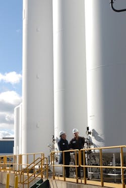

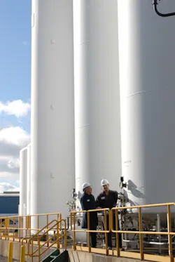

AIR MONITORING
Figure 1. Data collected around key hardware helped identify fugitive emissions at a NF3 facility. Source: Air Products & Chemicals.

In certain areas of the facility, particularly around rotating equipment such as compressors and near the reactors and loading areas, air monitoring instruments recorded fugitive emissions (Figure 1). Checking that compressors were leak-tight became a part of routine maintenance, as did monitoring piping around the machinery for vibration, which could result in additional leak points at certain piping-to-equipment connections.
"It is important to note that when you are trying to detect process leaks at these extraordinarily low values, even wind direction can be an important factor. The tests were repeated over a range of different environmental conditions, including time of day and various ventilation conditions," Kourpas adds.
