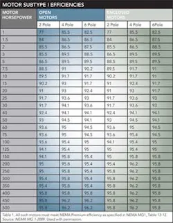

Motor Subtype I Efficiencies
Table 1. All such motors must meet NEMA Premium efficiency as specified in NEMA MG1, Table 12-12. Source: NEMA MG 1-2009. Used with permission.
