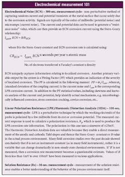

And even this technique provides only a retrospective check rather than continuous monitoring capability, according to Dawn Eden, marketing manager at InterCorr. Offline measurement techniques using electrical or linear polarization resistance only provide data periodically, and require that users download, then process, data.

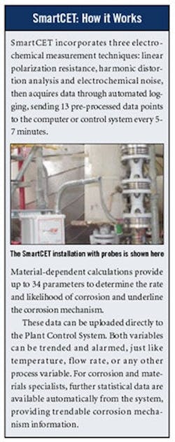

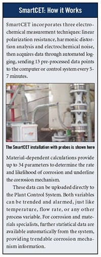

After convincing management of the need to take action, and studying the alternatives, the BASF team decided to install SmartCET at the facility. Installation was very quick -- a matter of days, according to InterCorr's Eden. There were some initial start-up problems with the system related to electrical noise carried by the plant's piping. These were eventually resolved and the system has worked well ever since.
Flange-style probes (Fig. 1) were customized for the facility to allow operators to monitor pipe surfaces at all times. The flange style was chosen for its durability and because it would allow the entire circumference of the pipe to be monitored at all times, an important consideration, since the pipe-wall corrosion was nonuniform.
The probes were installed in an 8-in.-diameter stainless steel pipeline where the most severe corrosion had been observed (Fig. 2). Probes made of carbon steel, 304L and 316L stainless steel were then inserted in the pipeline (Fig. 3), downstream of the caustic water addition and the injection point for another minor process stream. To meet safety requirements, the corrosion analyzers were placed in explosion-and weather -proof enclosures (Fig. 4).

The corrosion rate was shown to vary quite significantly with process and operational events. For example, the Pitting Factor and LPR corrosion rate show an inverse relationship when localized corrosion is occurring. Monitoring of general corrosion alone could not have brought these relationships to light. In addition, operators found that the LPR corrosion rate of carbon steel was directly connected with the amount of a key gaseous chemical used in the process, whose addition level inadvertently varied.

In January 2003, the system was integrated with the site's process information management system (PIMS), enabling plant operators and engineers to view real-time corrosion data alongside standard process variables (temperatures, pressures, flow rates, vessel liquid levels). During the early phases of corrosion testing, a list was made of process variables that could affect corrosion rates. Experiments were then run by adjusting one process variable at a time while monitoring the effect on corrosion rates and pitting factors.
