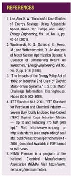

Unlike immediate motor replacement, immediate ASD installation may have a good payback. For example, one published study of nine cases of pump and fan ASD applications demonstrated measured energy savings in the range of 23% to 79% in the 7.5 hp to 125 hp motor size range [1].

For example, a centrifugal pump may benefit from impeller trimming to adjust the operating point. Many impeller trimmings pay for themselves in just a few months. Sometimes the choice is between an ASD and an impeller trimming, and the impeller trimming wins on the basis of lowest cost, lowest risk and sheer simplicity [2].

    EPAct does not guarantee a good motor efficiency selection since many motors are exempt from EPAct requirements. Exempt motors include motors larger than 200 hp; non-foot-mounted motors; rebuilt, repaired and rewound motors; and NEMA Design C and D motors [3].

    If you need a motor specification, consider referencing IEEE Standard 841 for severe duty, TEFC, squirrel-cage induction motors up to 500 hp [4]. You'll get heavy-duty motors with energy efficiency higher than EPAct requirements. Consider adding the NEMA Premium efficiency standard [5] for even higher efficiency (Table 2) and adding IP 55 bearing isolators under 40 hp. (They are already included for 40 hp and above.)
