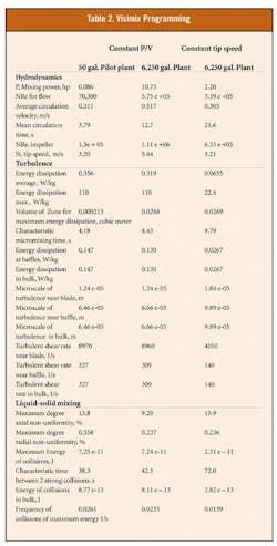

    Simulation and modeling
    The Visimix [1] program can be helpful in analyzing the mixing parameters in a crystallization and precipitation vessel. It can be useful in investigating different scenarios for scaleup and changes in agitator and vessel configuration. The author has used this program for many systems and has found that the results often match. Table 2 presents the results for a geometric scaleup from 50 gal. to 6,250 gal. The baffled vessel was a dished head with a 45 Degrees pitched-blade turbine. A saturated aqueous mother liquor contains 15% suspended solids, and the average particle size is 125 m with the maximum size being 350 m.
    Two cases were analyzed, the first being scaleup at constant P/V and the second being scaleup at constant tip speed, St.
    When scaling up with a constant tip speed, as expected, the turbulence parameters predict a significant reduction in energy dissipation rates, turbulent shear rates and an increase in the microscale of turbulence. The turbulence values for scaleup at a constant P/V are quite close to each other.
    The hydrodynamic values show the dramatic change in Reynolds number and mean circulation times.
    The liquid-solid mixing characteristics predict reduced values for the energy of collision, frequency of collisions and characteristic time between two strong collisions when scaling up on a tip-speed basis. This would predict the expected decrease in secondary nucleation.
    A summary of definitions for the predicted parameters is as follows:
    1. Maximum value of energy dissipation -- microscale phenomena -- energy dissipation behind the agitator blades -- controls breakage, nucleation and micromixing in this zone.
    2. Local values of energy dissipation -- microscale phenomena -- average energy dissipation plus energy dissipation in bulk slurry and at baffle -- controls breakage, nucleation and micromixing in these zones.
    3. Characteristic time of micromixing -- time of microscale degradation of non-homogeneous concentrations -- important for precipitations.
    4. Shear rates -- characteristic shear rate at the microscale level --scaleup governs mass transport process for growing and dissolving solids.
    5. Maximum energy of collisions at zone of maximum turbulence near impeller blades -- collisional energy of particles -- higher values increase breakage and secondary nucleation.
    6. Energy of collisions in bulk -- collisional energy of particles -- although less than the maximum value, the large number of collisions in the bulk can affect breakage and secondary nucleation.
    7. Frequency of collisions of maximum energy -- predicts how often the slurry particles see the maximum collisional energy -- if higher, more breakage and secondary nucleation.
    8. Time between two strong collisions -- average period of uninterrupted crystal growth.
