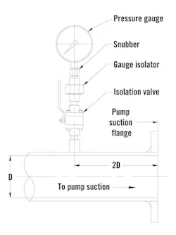

Pressure is one of the most commonly measured process variables. Most plants have hundreds of pressure gauges. Unfortunately, many of these have broken lenses and wiggling needles. These gauges often do not give an accurate representation of system pressure. Therefore, every maintenance department should purchase a set of quality gauges for use only in the troubleshooting and performance verification process.
Fig. 1 illustrates the system that can be used to mount the test gauges. These gauges should be kept in calibration, clearly marked as test gauges only, and stored in a clean restricted-access area such as a locked maintenance cabinet.
Figure 1. Test Gauge Setup
Every facility should have high-quality gauges dedicated solely to trouble-shooting and performance verification.
The pressure snubber protects the gauge from process pressure spikes. If you buy a high-quality gauge, then spend an extra $15 to protect it from spikes. A gauge isolator also is recommended. It can prevent gauge or process contamination. It also allows the use of less noble metallurgy for the gauge, which might represent a significant cost savings if your process requires exotic metallurgy. The valve is essential for the isolation of the test gauges and must meet all process fire and safety requirements.
You may take pressure measurements at any location close to the pump. Many process pumps have tapped pressure connections at the suction and discharge flanges. For performance verification purposes, these will suffice.
If you have to install taps for the pressure gauges, the Hydraulic Institute standards require the suction and discharge pressure tap locations to be two diameters of straight pipe from the pump suction and discharge. Locate the taps as close as possible to locations specified in the Hydraulic Institute Standards to get the most accurate results.

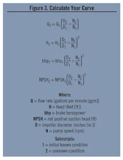

If a curve is not available for the correct operating speed or if you cannot obtain a curve for your trim diameter, you can use affinity laws to approximate pump performance. Using data from an existing performance curve at a different speed or diameter, you can calculate the data for the curve you need. The formulas are shown in Fig. 3. They can be used to change diameter, speed or both. The results of these calculations are approximations of the actual values. The affinity laws assume that efficiency is constant for small changes in speed or diameter.
A free downloadable Microsoft Excel spreadsheet that does the conversions for you can be accessed at www.mechtronixeng.com. Many existing software programs also will handle the affinity law calculations. Many manufacturers provide data in an electronic format, either in a proprietary program or commercially available software. One example is Pump-Flo from Engineered Software (www.pump-flo.com).
These programs often allow the user to adjust the performance curve for changes in impeller diameter, speed, viscosity, specific gravity, etc. The user then can plot a custom performance curve for the application.

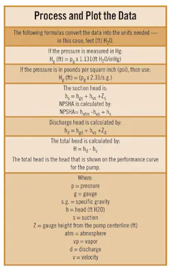

After you collect the data, you need to process them and plot them on the performance curve.

Based on the flow rate and the suction and discharge pipe sizes, the velocity heads are found to be:
hvs = 1.69 ft and hvd = 8.18 ft
From references, the fluid's properties at the pumping temperature are:
pvp = 0.65 psia at the pumping temperature
s.g. = 1.221
viscosity = 1.45 centipoise (cp) (viscosity change is
negligible ," no correction needed)
First, calculate the NPSHA:
hgs = [23.5 in. Hg x 1.131(ft H2O/in. Hg)] = 26.58 ft
hs = -26.58 + 1.69 + 0.5 = -24.39 ft
hvp = (0.65 x 2.31)/1.221 = 1.23 ft
hatm = 33.94 ft
Therefore:
NPSHA = 33.94 - 1.23 -24.39 = 8.32 ft
Then we calculate the discharge head:
hgd = (26 x 2.31)/1.221 = 49.19 ft
Therefore:
hd = 49.19 + 8.18 + 1 = 58.37 ft
Total Head:
H = 58.37 - (-24.39) = 82.76 ft
