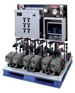

Custom packaged feed systems
Increasingly, facilities are using custom packaged chemical feed systems. Here, the solutions provider designs the entire system specifically for the application and builds it off-site.
After the "modular" system is thoroughly tested, it then is delivered to the plant on a skid. Electricity is established and plumbing connected, and interface connections are made to the plant's distributed control system (DCS) at a junction box (or, depending on the needs and capabilities of the plant, the packaged feed system is designed to include local automated control with wireless interface capabilities).
Although packaged chemical feed skids long have been available, their use was more limited until relatively recently, partly because few companies possessed the necessary skills to provide fully integrated packaged systems. Although some pump manufacturers provide packaged systems, the resulting systems often are not designed with an understanding beyond the boundaries of the pump. However, several full-service packaged system providers have been established over the past several years to meet the need for optimized, site-specific chemical feed solutions.

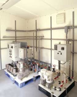

Some plants are simply too old to make a complete overhaul of existing systems economically and/or physically feasible. In many older refineries, for example, the cost for hardwiring the plant for systemwide distributed control alone is sky high. However, for these and many other older plants with outdated equipment, packaged feed systems can provide tremendous opportunities for automation, optimization and safety.
Self-contained systems can be designed and built to meet the precise needs of the process while also providing local automated control. A variety of different wireless communication options can be incorporated into the system design to allow the plant to monitor and access critical performance data via the Internet or other communications options.
Incorporating these stand-alone systems in areas of the plant experiencing the most problems often can bring results that are both impressive and sustained. Used throughout an aging, outdated plant, these site-specific packaged chemical feed systems can create "pockets of excellence" that bring significant improvements and allow the plant to be competitive in its most critical processes.
A custom packaged chemical feed provider custom designed the entire system shown here.
