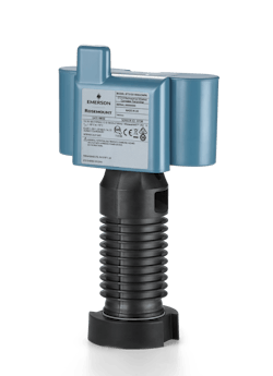

The Rosemount Wireless Permasense ET310C Corrosion Transmitter (Figure 1) provides direct measurement of pipe wall thickness, the most accurate indication of asset integrity. The transmitter uses patented signal processing to measure wall thickness and metal loss on any metallurgy, supported by best-in-class material and temperature compensation. Measurement data from the transmitter enables monitoring of corrosion activity to help determine when preventive measures, such as adding inhibitors, are warranted.

Measurements are wirelessly transmitted using the industrial WirelessHART protocol at intervals set by plant personnel, typically once every 12 hours, representing a substantial improvement over monthly — or more — manual measurement frequency. These non-intrusive, intrinsically safe transmitters can be installed without any piping penetrations by simply affixing them to piping with a polymer strap. Once installed, each transmitter is automatically recognized by the network and begins transmitting data to a host system.

The transmitter uses electromagnetic acoustic transduction, optimized to work even with non-ferritic metals, and transmitters can be installed without interrupting operations. These devices use an electromagnetic field, rather than the mechanical vibration of a piezo transducer, to excite an ultrasonic wave in the pipe or vessel wall. The electromagnetic field between the sensor and the pipe effectively becomes the couplant. This eliminates the need for a gel or physical couplant, extending periods of maintenance-free operation compared to technologies requiring a couplant, as it requires frequent attention.
