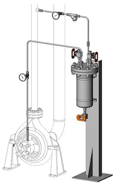

Most plants historically have handled fluid conveyance with piping, which typically is made from carbon steel and features numerous threaded connection points throughout each run. So, sites often also turned to piping for seal support systems. However, the current edition of API 682 recommends reducing threading and connection points wherever possible. This guideline has fostered a notable shift to bendable tubing systems becoming the preferred choice among seal manufacturers, end-users, and pump original equipment manufacturers. Plants also have the option to weld carbon steel pipe to minimize threaded connections but the corrosion resistance, flexibility and efficiency benefits of using stainless steel tubing often tip the scales in its favor.
Comparison of Connections
Figure 1. Opting for tubing instead of threaded piping can reduce the number of connection points significantly and, thus, the potential for leaks.
By design, tubing can reduce the number of connections to just those at the mechanical seal and the seal support system (Figure 1). Therefore, the system might only have two to four potential leak points, depending on its configuration. Minimizing the number of connection points and reducing leak potential are possible due to a variety of factors, including:

The use of tubing provides further financial benefit when examining the maintenance, repair and operation (MRO) costs of the pump, seal and support system. During maintenance operations that require reworking welded piping around pumps, using tubing instead can eliminate the need for costly on-site welding and also speed installation time to reduce downtime.
While bendable tubing offers efficiency benefits to cut installation and MRO labor costs, it is more expensive than carbon steel piping; it can become particularly expensive when using special alloys to combat corrosion. Construction of piping systems in special alloys also is possible but material options are more limited. Therefore, system designers may need to weigh the overall costs of using either tubing or piping — while also factoring in corrosion resistance, aesthetics, MRO activities, supply logistics and more — to make a decision.
Carbon steel piping is perfectly acceptable for many seal support systems such as flush plans. However, it can pose a risk for applications in which moisture is present and internal corrosion is a possibility. For example, the scale that commonly builds up on the inside of carbon steel pipe can break away, flow downstream and then lodge in the gap between seal faces or clog an orifice. Using carbon steel in systems where scaling is a possibility calls for scheduled preventive maintenance (PM) and close monitoring of the system.

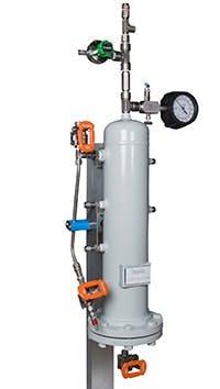

2. Simplify maintenance. Like the equipment they support, seal support systems typically operate continuously — so, their reliability is crucial. Using high-quality materials (Figure 3) and ensuring the systems are well maintained are important to prevent leaks and costly downtime.
Seal support systems contain commonly serviced items, such as strainers, flow meters and other instruments. Placing components in inconvenient locations can hinder their getting proper attention and adequate PM, especially if a plant is understaffed. Design should ensure operators can simply and safely perform PM on these systems. A well-designed and dependable system can help a plant reduce maintenance needs and costs.
Consider the process for performing general pump maintenance, which requires blocking in and draining the pump and support system. A well-designed support system can simplify this maintenance requirement by including low-point drains that allow purging of fluids quickly and safely. High-point vents also are important to include for removal of any entrapped air. Providing installers with the proper tubing and components, along with a drawing showing where to place vents and drains, ensures correct system installation and easy performance of future maintenance.
API 682, 4th ed., also recommends using block-and-bleed configurations for all gauges (Figure 4), so technicians can swap out a broken gauge with ease. If systems don’t include this feature, as gauges fail, operators likely will lack critical information until the pump and support system can be decommissioned to replace the gauge.
For seal pots, API 682, 4th ed., encourages easy accessibility. It (in 8.1.8) stipulates: “Local operation, venting, filling, and draining shall be accomplished from grade. Unless otherwise specified, systems that require the use of a ladder or step or that require climbing on the baseplate or piping are not acceptable.” Many plants have older seal pots with just a pipe plug at the top. Having operators climb a ladder to top off the pot can expose them to process vapors and generally is an unsafe practice; so, avoid this altogether.
Lastly, a wide variety of tubing connections and design options exist that allow easy removal and replacement of every serviceable component in a seal support system while continuing to operate the system. Implement these technologies wherever possible to help simplify and streamline seal support system maintenance and operation.
