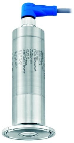

Endress+Hauser released the Liquipoint FTW33 point level switch for liquids. Designed for hygienic processes, the FTW33 meets FDA requirements as well as 3A Sanitary Standard Number 74. It can be used in pipes and in storage, mixing and process vessels, with or without an agitator.
The Liquipoint FTW33 conductivity sensor was built for tough applications in the food and beverage market. The Liquipoint FTW33 measures the presence of conductive liquids with an electrical conductivity greater than 1 µS/cm. It also has an optional build-up compensation feature that allows it to switch reliably in heavy build-up and viscous products like tomato paste, honey, molasses and peanut butter. The sensor can also be used for detecting the foam that commonly occurs in the food industry.
Materials in contact with the process are made of 316L stainless steel with PEEK insulation, making the FTW33 suitable for use in processes that require cleaning and sterilization. The sensor can be used in process pressures from –14.5 to +362.5 PSI and temperatures up to 212°F (100°C).
It can also be used in cleaning and sterilization processes to 302°F (150°C) for up to 60 minutes, and is resistant to typical cleaning agents. The sensor has a DC-PNP 3V switching output when it can be used for point level. These signals are typically used for overfill and high level detection or for low-level detection to prevent a pump from running dry.
