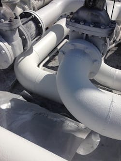

In contrast, thermal insulative coatings are spray-applied to exposed surfaces and don’t require cladding to mitigate burn potential (Figure 2). The coatings can be used almost anywhere that traditional insulation systems are. Just a few simple-to-apply layers of material make the coated surfaces safe to touch. By obviating metal cladding, the coatings also completely eliminate the threat of hidden CUI.
The coatings contain ceramic microspheres — small beads filled with air — that create a high air content in the final dried coating surface. This air acts as an ideal insulator, limiting the transfer of heat energy through the coating so exterior surfaces remain safe to touch for at least the OSHA-mandated 5-sec threshold. Even dangerously hot systems like steam piping and boiler ductwork may be coated to prevent burns to personnel.

Coated Pipeline
Figure 2. A spray-applied coating system helps minimize burn hazards as well as maintain the internal temperature of this crude oil pipeline that operates at 180°–200°F.
