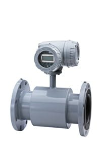

Electromagnetic. Such meters employ Faraday’s law of electromagnetic induction, whereby voltage is induced when a conductor moves through a magnetic field. The liquid acts as the conductor, with energized coils outside the flow tube creating the magnetic field. The produced voltage is directly proportional to the flow rate.
An electromagnetic meter (Figure 2) will measure virtually any conductive fluid or slurry, including process water and wastewater. The devices provide low pressure drop, high accuracy, large turndown ratio and excellent repeatability. The meters have no moving parts or flow obstructions, and are relatively unaffected by viscosity, temperature and pressure when correctly specified. Electromagnetic meters tend to be heavy in larger sizes and may be prohibitively expensive for some purposes.

Electromagnetic Meter
Figure 2. These devices can monitor virtually any conductive fluid or slurry found at a plant.
