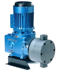

Diaphragm Pump
Figure 2. This single-acting diaphragm pump uses corrosion-resistant plastics for wetted parts. Source: Grosvenor Pumps.

Diaphragm Pumps
These pumps use reciprocating movement to pulse a flexible membrane — usually made of rubber or a fluoropolymer or other thermoplastic — to displace liquid with each stroke. The liquid doesn’t penetrate through the diaphragm. Diaphragm pumps usually possess good suction lift characteristics. The devices produce pressures to 100 Barg; special variants can achieve higher pressures. These pumps usually require no seals; this suits them for handling abrasives and slurries. In addition, they are a good choice for dangerous, toxic or noxious liquids because they obviate issues of leakage through seals or packing. They also have good self-priming capabilities and dry-running characteristics. Some units boast efficiencies that reach as high as around 97%.
Diaphragm pumps often are electric motor driven (such as the one shown in Figure 2) but pneumatic- and hydraulic-powered units also are available. The pumps can be categorized by what’s on each side of the membrane:
• Process fluid on one side and compressed air or hydraulic fluid on the other. Such air-operated or hydraulic pumps can be used in areas where electrical devices aren’t suitable or would be very expensive because of explosion-proof or electrical-area-classification requirements; in other words, they are popular for many applications to avoid area classification problems or intermittent electric power availability issues. They are more compact and lighter than other designs.
• Process fluid on one side and ambient air on the other. Diaphragm flexing occurs due to the action of a crank, geared motor drive, lever or other mechanism. These pumps usually are more energy efficient than other designs. One reason is because the drive system doesn’t require expensive compressed air or hydraulic oil. In addition, they can be tailored to the needs of the specific application.
Such pumps most often are electro-mechanical double-acting designs. In these, the integral metal core of each membrane is completely covered by the membrane material on its fluid pumping side, minimizing the possibility of fluid contamination. The smooth mechanically controlled linear drive of the membranes can ensure low-shear transfer at precisely controlled rates even when viscosity, pressure or other operating parameters change. A variable frequency drive can enable easy adjustment of flow rates. An external electrical control device such as a pressure switch can limit maximum discharge pressure if necessary.
