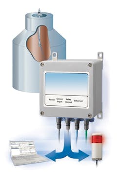

 Acoustic Monitoring Device
Figure 5. Unit mounted on onside of vessel detects loss
of rotation and variations in rotation speed and fluid pressure.
Once you've selected and installed a new cleaning machine, how do you know if it's doing its job?
Visual inspection is one option. Monitor the machine to make sure it's working and inspect the inside of the vessel when the cleaning cycle is complete. Swab or riboflavin tests are common ways to verify cleanliness. Of course, the viability of these approaches depends on the size and location of your vessel.
Another option is using an acoustic monitoring device (Figure 5). A sensor mounted to the exterior of the tank "listens" to the performance of the cleaning equipment and identifies variations from a pre-determined baseline. It instantly can detect rotation failure and changes in rotation speed or spray pressure and can notify operators via audible or visual alarms. The monitoring device also transmits performance documentation for quality control and record keeping. It obviates visual monitoring and post-cleaning tests.
