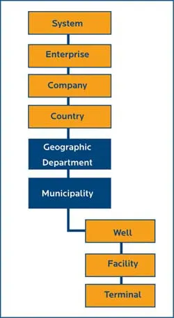

Any attempt at data consistency will involve the use of conversion and aggregation. Trying to make disparate systems use the same units of measure, same naming, same time aggregation, same geographical aggregation and the same material aggregation is a losing battle (Figure 2).
Figure 2. Collecting data at a plant and sharing it within the corporate structure can be a complicated affair.
